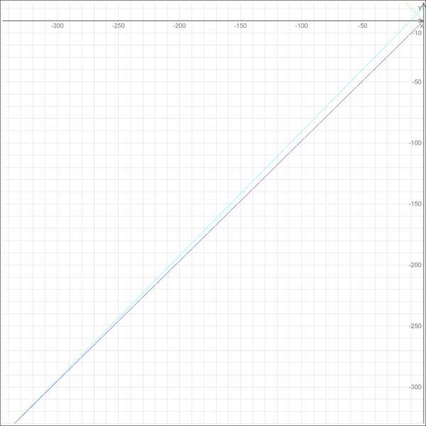

I find that the best way to dispel confusion with a relativity problem is usually to draw a spacetime diagram, so I've attached one.
The diagram is drawn in the Earth frame and is scaled in kilometers (vertical distance on the x-axis, time in "light-kilometers" on the y-axis). The red line is a light ray from x = 60 km height at time t = 0 (Earth time), to zero height at time t = 60 km. The blue line, just above the light ray, is the worldline of one of the muons; I've used different specific numbers than the Taylor-Wheeler problem uses so that the difference in lines is visible on the diagram, and this worldline crosses the y-axis (which is zero height) at t = 61 km, meaning the muon's velocity is 60/61. (This means, of course, that it takes many more than three half-lives to complete the journey with the numbers I'm using; but the principle involved is the same with the numbers actually given in the problem.) This gives a gamma factor of 61/11, so only 11 km of time elapses in the muon's frame as it falls from 60 km to zero height.
The magenta line is the "line of simultaneity" in the muon frame, at the event where the muon starts out at x = 60 km. As you can see, this line crosses the y-axis at about t = 59 km; the actual slope of the line is 60/61, the inverse of the slope of the muon's worldline, so it actually crosses the y-axis at t = 3600/61 = 59.0164 km (to 4 decimal places, at least). So in the muon's frame, the Earth is rushing towards it at v = (60/61)c, and only 1.9836 km of time elapses on the Earth's clock (which is gamma times the 11 km elapsed in the muon's frame, as expected); *but* that time elapses between time t = 59.0164 km and t = 61 km on Earth's clock (i.e., between the magenta line crossing the y-axis and the blue line crossing the y-axis), so when the muon arrives at zero height, Earth's clock reads 61 km, *not* 1.9836 km.

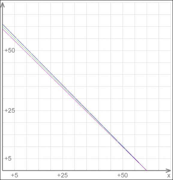

Just for good measure, here's another spacetime diagram drawn in the muon's frame. :wink: The scaling is the same (km distance on x-axis, light-km of time on y-axis), and the lines are as follows:
The green line is the same light ray as in the previous diagram.
The y-axis is the muon's worldline, and the x-axis is the line of simultaneity at the time the muon is at 60 km height as measured in the Earth frame--in the muon's frame, as you can see from the diagram, the distance is the "length contracted" distance of 60*(11/61).
The cyan line is the Earth's worldline (which crosses the x-axis at the "length contracted" distance just given), and the blue line is the Earth's "line of simultaneity" when the muon is at 60 km height in the Earth frame--in other words, the blue line is the same line that appeared as the x-axis in the "Earth frame" diagram in my previous post (and of course the cyan line, the Earth's worldline, was the y-axis in that diagram).
The (x, y) coordinates where the blue line meets the cyan line (which is the point that appeared as the origin in the previous diagram) are x = - 3660/11, y = - 3600/11. These are, of course, just the right values such that the "length contracted" distance to the origin along the blue line is 60 km, and the "time dilated" proper time along the cyan line to where it meets the y-axis (at y = + 11 km, which is the elapsed proper time to fall in the muon's frame) is 61 km.
GregAshmore said:
Because the Earth distance is zero in its own (rocket) frame
The distance in Earth's frame is not zero. The birth of the muon occurs at the top of the atmosphere and the decay occurs at the bottom. Those locations have different coordinates in the Earth frame.
If the travel distance of the muon is zero in its own frame when the problem is set up with the muon as the rocket, why isn't the Earth's travel distance zero in its own frame when the problem is set up with the Earth as the rocket?
The Earth's travel distance is zero in the Earth's frame (by definition), but aren't you interested in the spacetime interval for the muon? Nothing interesting happens to the Earth in this problem (i.e. there are not two different events identified on the Earth's worldline).
I'm trying to analyze the problem from the point of view of the muon, without prejudice, so to speak. That is, if I were sitting in place of the muon observing the Earth go by, how would I interpret what I see according to SR?
I measure a certain time on my clock. In that time the Earth travels a certain distance as measured in my frame. (We assume that I know this distance by some means, analogous to our means of knowing the distance traveled by the muon in Earth's frame.)
With those two pieces of data--time and distance in my frame--and the knowledge that the Earth's travel distance is zero in its own frame, I can calculate the time in the Earth's frame. That time is the proper time for the event.
AND...now I see what I did wrong.
The reason this approach is wrong in this particular case is that the conditions are not truly the mirror image (so to speak) of the original problem.
In the problem as originally stated, the time of the event (the muon's life span) is first measured while the muon is at rest in the frame of measurement. That time, the muon's own time, must always be the time assigned to the event in the muon's frame, no matter which other frame is the viewing frame.
To be true to the form of the original problem, my construction of the problem should have first measured the time of an event in the Earth's frame (but not the life span of the Earth--much too long for the muon). That proper time, together with a distance in the muon frame, would be used to calculate the time in the muon frame.
The way I constructed the problem, I took the time and distance in the muon's frame and calculated the proper time of the event. That's fine--but that event is not the same event as in the original problem.
Which means that I took the long hard road to get to what you were trying to tell me in your reply.
